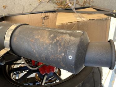

I just received my x22 from venom today and was super excited. Felt like Christmas. I didn’t have high hopes about the fit and finish but this is a little much. The muffler has obvious rust and the box looked like someone walked all over it. Again no big deal but it will not start.

Added pics of box and muffler
