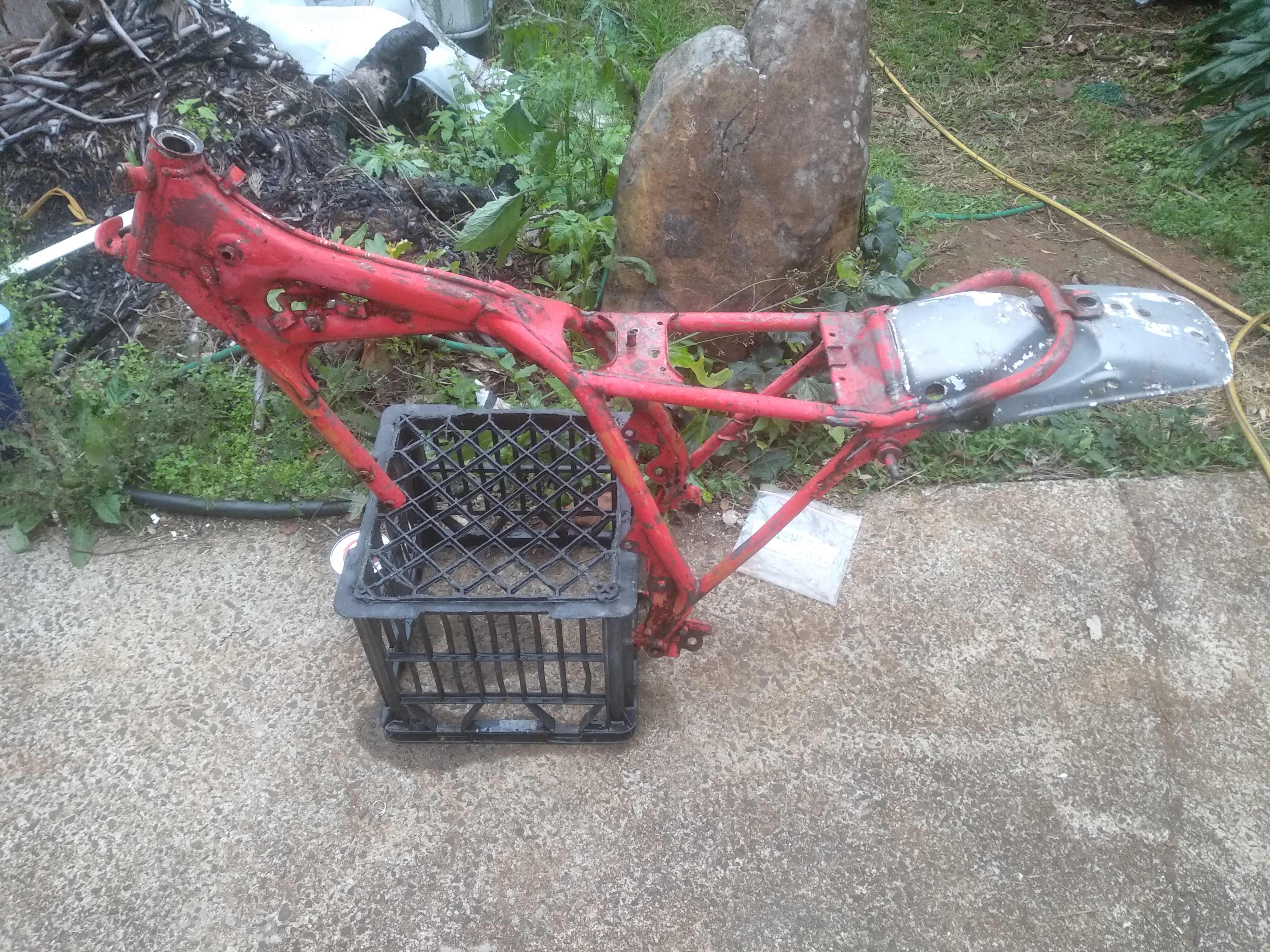

1981 XL185S Pooched Parts Bike
Trying to find a Decent parts bike to have some spares around incase my XLCG250 needs them.
I found this and payed a deposit so basically committed to purchase site unseen.
It was close enough that fuel and time wasn't a major pain.
No Idea what the history is other than it's a 1981 (same Vintage as me)
The seller had bought some lawn mowers and this was part of the sale agreement(take away)
I was mainly interested wheel/rim/drumbrake assemblies and I think the chrome will polish out and they seem straight. Triple tree is good front shocks usable, rear shocks seem fine.

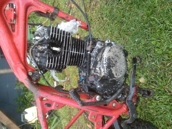

The engine turns and has compression.
The box of miscellaneous parts had a gasket kit and piston rings...so i think someone was prepared to have a go fixing it but then tapped out.

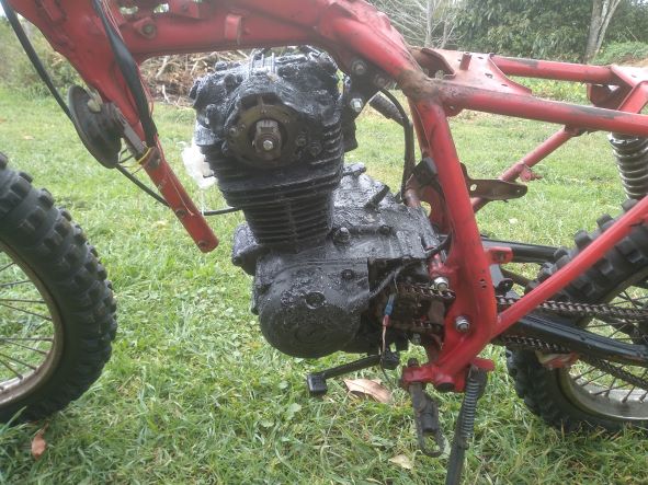

The engine has been coated in some heavy black enamel paint/bed liner coating with no masking effort aka PITA.
But there is no ignition wiring.

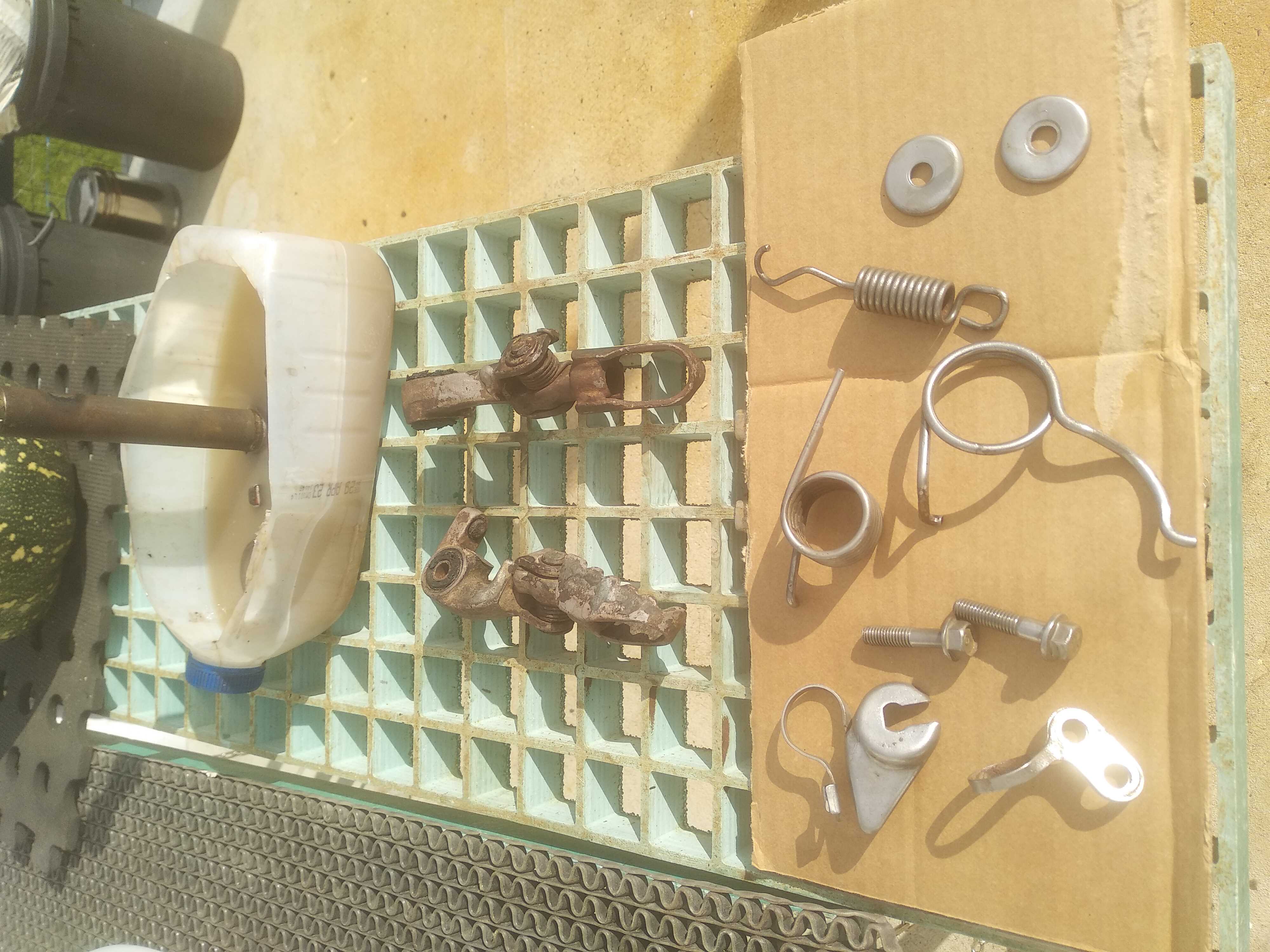

most of the hardware has been replaced with discount hardware's finest.
Taking the non matching seat that was screw bolted into the side off the frame and fuel tank that is dented beyond hope...
The discovery is the frame had snapped near the top engine mounts and was welded back...I suspect it was ridden with the missing front engine mounts...
Any what this means is this frame is no good for roadworthy.
However I think I might try to make this poor clapped out 81 into a twinshock trails/backyard basher bike.
The project XL/CG250 road legal bike is still main priority.
going to sell off the non used original parts to recoup some costs first.

looks are deceiving, Most of the bolts are not original.
the frame has snapped and been welded...will not pass a road safety inspection.
The motor is missing the sprocket cover, points/CDI cover and some case bolts.
I am hoping the black heavy paint will respond to paint stripper. not So sure about dumping $ more into a beater.
However I have no problem hacking into it.
Some other bits like the rear brake return spring ,wheel adjustment/chain tension bolts are gone.
I would probably have to get another bike just to save this one. It's basically junk but might be able to sell the non essentials like the side plast+airbox, splash and rear guard as-well as the gauge cluster and loom to a point where the wheels, hubs, swing arm and front shocks were worth the effort.
The rear tire holds air...I guess that's something.

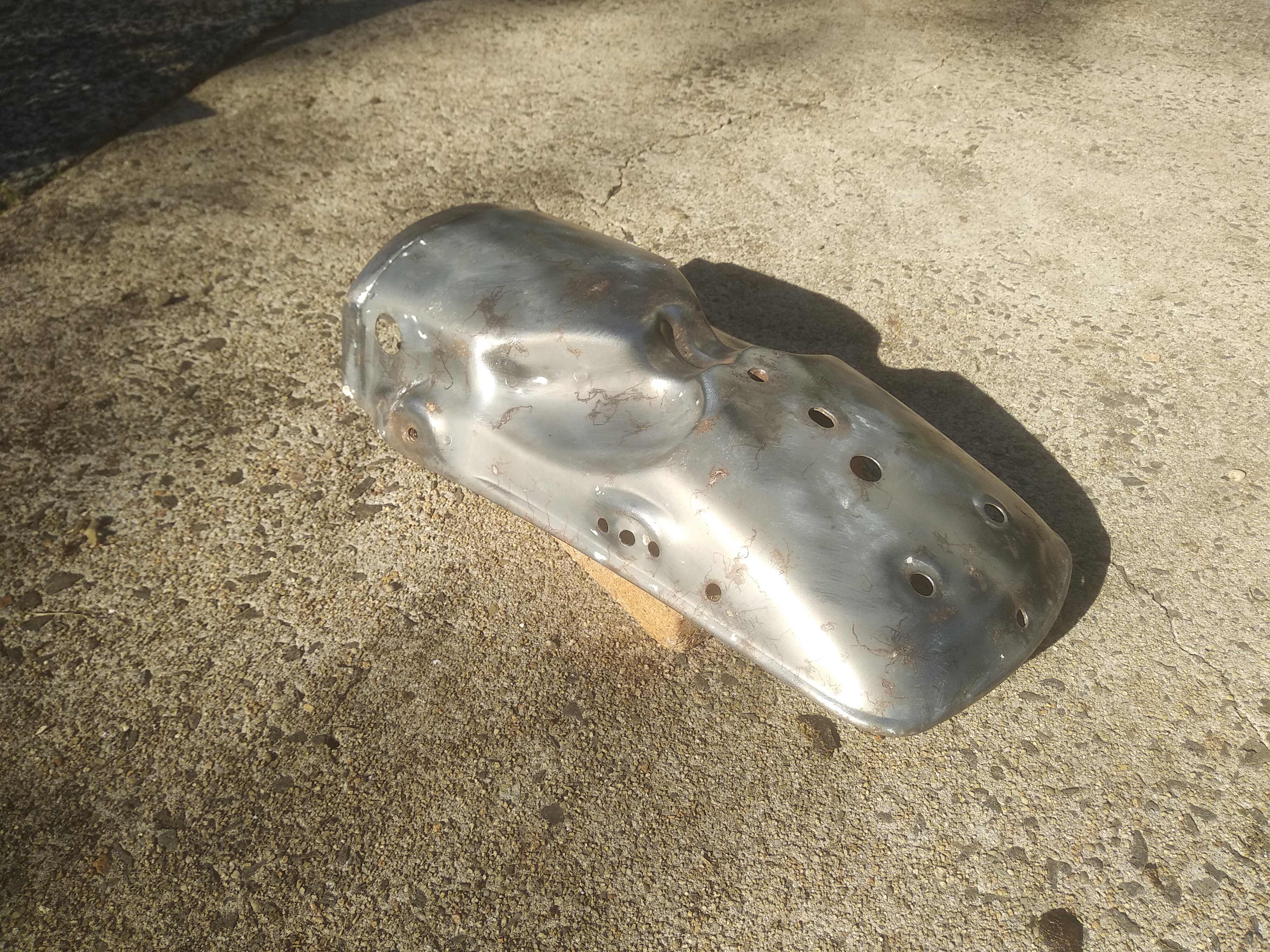

I think its beyond hope.
I thew some remaining paint stripper on the engine to see if it will clean up ok...
Results look promising.
however the back sprocket is cracked. So any intentions of putting time and finances into this particular bike is pretty much dusted.
However the sum of its parts is still justified.
The rims should clean up ok and there are a number of legitimate spares for the main bike now.
The current rolling assembly will be rolled under the house for storage.
In case another better spares/parts bike perhaps becomes available.
I should be able to hobble together 2 runners with spares out of 3 bikes but I think I will be drawing a line after that.

Fender Bender Mender...
Rear guard...
After the paint strip and pressure was..
next was a wire wheel followed by a plug weld to fill excess holes...
then grind and flap disk...
then rust treat...
then JBweld fill and sand...
Then Paint.
