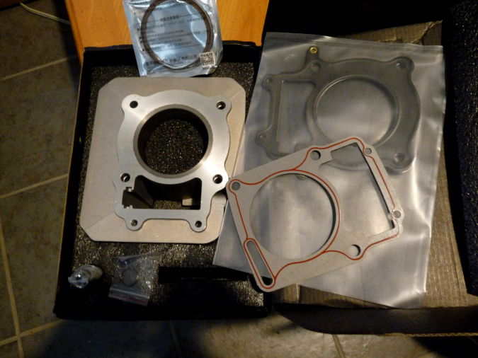

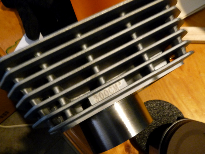

I bought that kit (Otom "300cc" piston/cylinder).
Oh it is a NICE kit. Complete, and the machining and parts look excellent. All gaskets, orings, gudgeon pin/circlamps, piston rings. Very nice kit.
But I was dismayed when I found out it was just a 74mm bore. YUP, that increases displacement by 14cc (249.99 to 264.07). I wouldn't call that a 300cc kit, even though 300cc is cast into the cylinder (see it in the photo). At least the advert you found admits it is a 264cc kit!
For me, it's NOT worth it unless I also add the cam, port the head and maybe get a slightly larger diameter carb. All together, it would probably make a big difference (maybe up to 24hp). The most noticable difference might be in the midrange torque feel, and off the start torque would probably feel spunkier and more willing.
