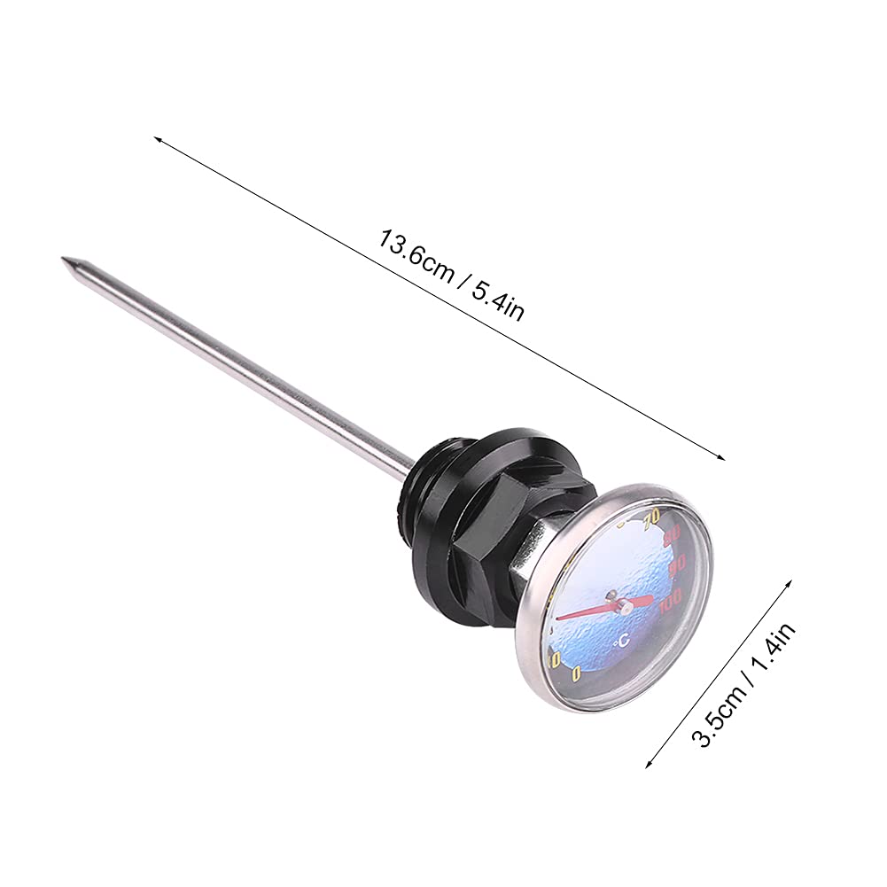

I really like that oil temp gauge/cap but can't find one other than HTT-1. I did find the manufacturer. Now I need to measure my oem oil dipstick unless someone already knows the length. I'm hopeful that one of these HTT-3/4/5/6 caps will work.
I used the bike for a short street trip that resulted in 175° temp. I definitely think it needs a oil probe touching the oil. Also I don't like firing up any small engine before first checking the oil level.
The HTT-2 is threaded for a probe like the pictures you attached showing the HTT 3/4/5/6.. Going to thread some stainless or aluminum rod & taper it down on the lathe to see what temperature results that gives. Never used one of these before pretty cool.
I agree that the temp. reading should be more accurate with a probe bathed in the oil. Checking the oil level before firing up is a great habit.
I'm very interested in your idea for adding a probe/dipstick to the HTT-2. I think the HTT-2 is by far the best looking oil temp gauge/cap that I've seen. Is it already threaded? I've only seen photos and it looks like it has a hole for a set screw to retain a dipstick. Either way if you can add a functioning temp probe/dipstick to the HTT-2 it'll be awesome!

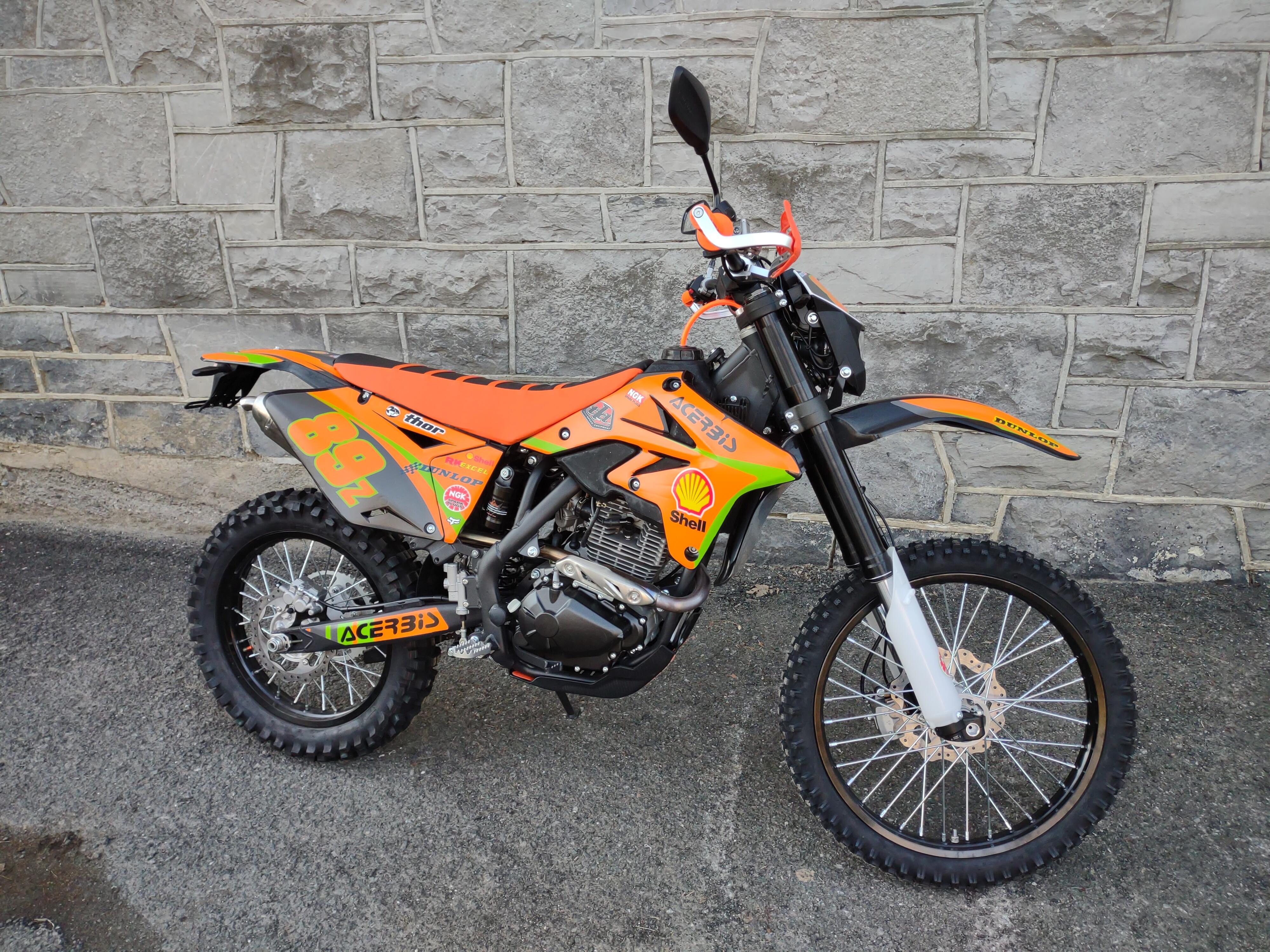

Final fitment done
Well, I finally got it all fitted up proper.
The skid plate that fits the M requires a bunch of work to fit the X.
Now I have it half part again to do the valve adjustment, add the intake gasket, change the oil and then hopefully fire it up.
Thanks to all on here that give such great information to make this process easier.

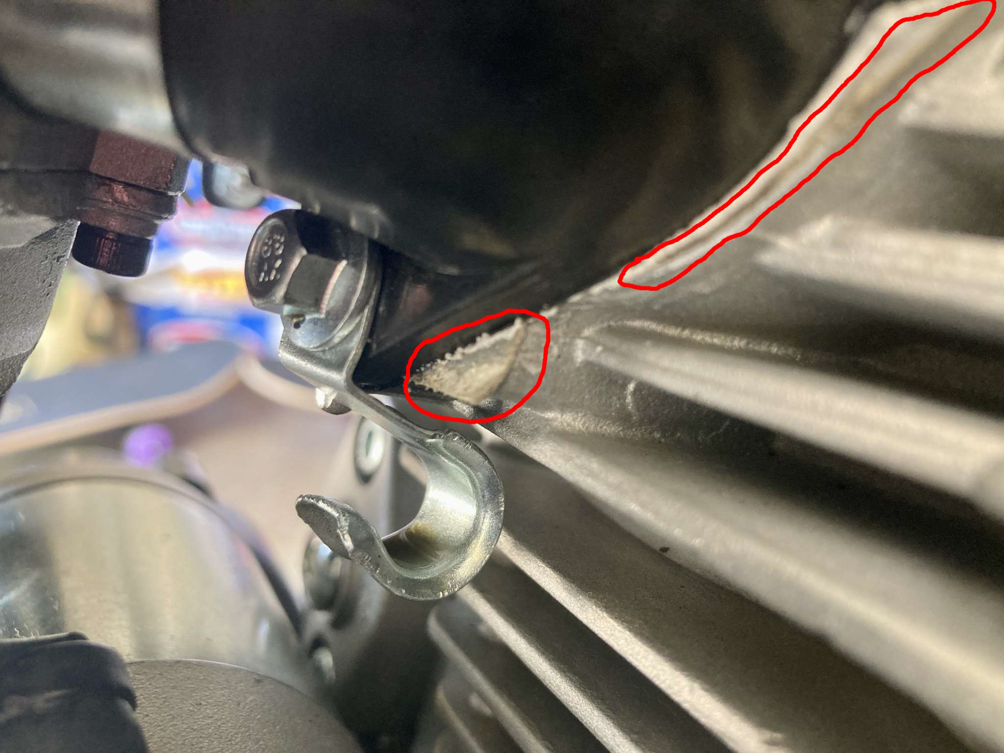

The non-existant existing intake gasket.
I took a ton of photographs from the previous work done in the post above. One thing I decided to grab while I had parts of the bike and good access was the intake gasket.
Everyone has reported no gasket.
I even thought I had no gasket, all my work on the intake manifold has been from the top and from the side looking down. Everything looked like gray metal to me.
However, after working on it, I had the skid plate off the bike and was looking around the bottom of the motor when I looked up at the intake manifold and said to myself, WTH?!! I clearly saw a gasket corner. I wiggled the corner back and forth with my fingers just to make sure it really was and it did flex and as it flexed the gray coloring flaked off and it became a lot easier to see that it is indeed a paper/material gasket of some sort.
I took a photograph of it in case internet detectives would like a look. Maybe with this angle and photograph it may encourage a few more in depth bottom up inspections under the intake and see if I am a rare one off with gasket on my Templar X 250 or if there are others out there that discover similar on their bikes.
So this doesn't fit the base Templar. The frame is in the way. The threads match but it's too tall. It might fit the X/M. I haven't heard back from HSI (HTT maker) and I'm done for now. Maybe if the HTT-2 becomes available again I may buy one and mod it with a dipstick.
