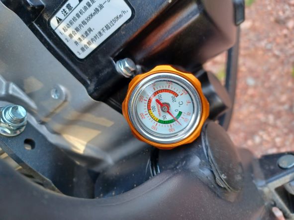

I was wanting to find an analog oil temp gauge to monitor my new Templar X. I saw throughout this thread the Suzuki RMZ250 was quite a similar bike to the Templar. So I took a chance and bought this oil cap gauge which fits that Suzuki. Can confirm fits the Templar X perfect! (Note: this is the HTT-2 model)

I am having trouble getting the Templar to start for the first time. Right now I am thinking its either valves, or carb is clogged perhaps. When I get it running I will update on if this temp gauge works/provides some value.
