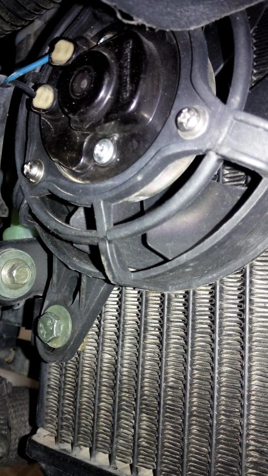

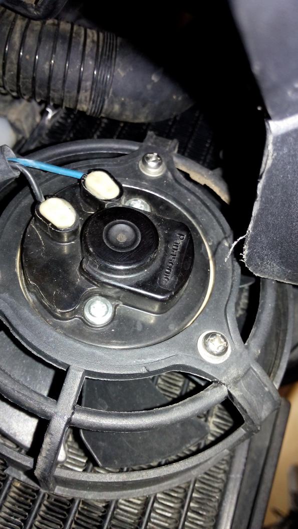

I checked mine and noticed two things: my fans are different, they have a cover over the rotating fins, and the top hose is routed far of it, anyway. So thanks for the heads up and the additional peace of mind.

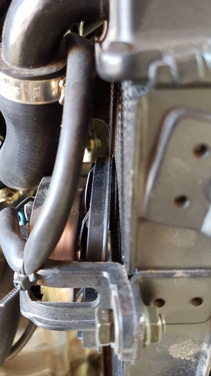

Last week I´ve found the same situation but on both radiators.
The water hoses pushed over one half of the plastic holding piece, bending it against the radiator surface.

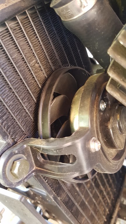

Left assembly:

Right assembly
Name:  right assy [1024x768].jpg

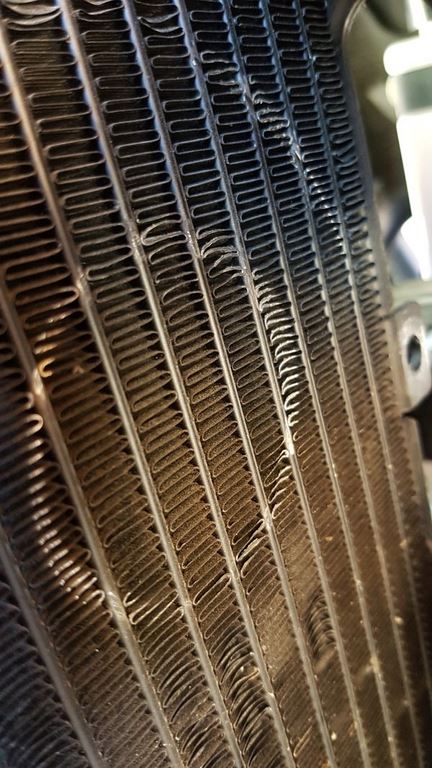

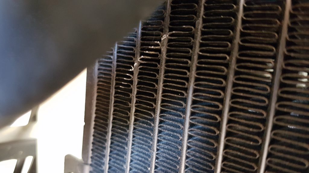

On my bike (350miles only) the fan just touched slightly the right radiator surface; but at the left side it eroded the surface and two wings of the fan become broken.
Left radiator:
Name:  left radiator [1024x768].jpg
Left fan:
Name:  left fan [1024x768].jpg
Right radiator:
Name:  right radiator [1024x768].jpg
