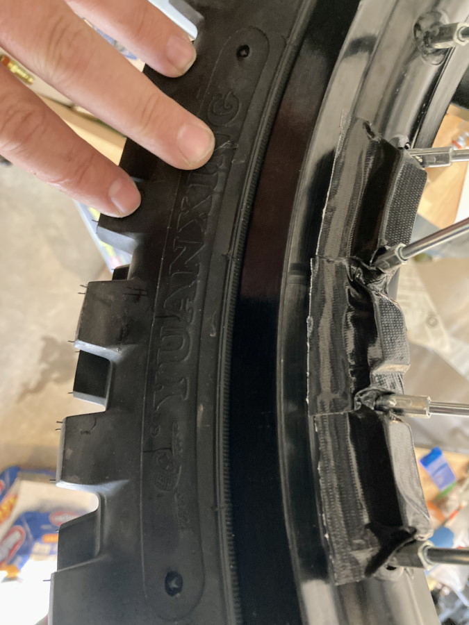

Removed the front tire and pulled the rim lock out of the rim. It also on further inspection before reinstalling the tire into the rim had a foam pad as well so I pulled that and put it together with the rim lock itself.
Name:  Front Tire Removed and Rim Lock Pulled.jpg
Looking closely at the rim lock there is some details on it, even a 2017 patent

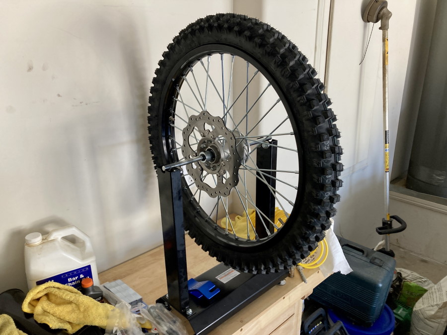

Time to put the front wheel on the balancer tool and figure out how it looks prior to installing weights. The wheel without the rim lock was surprisingly in balance, nothing major, just a slow spin to the heaviest point, which of course was the valve stem.
Name:  Front Tire on Wheel Balancer Tool.jpg
I used two 1/2 ounce weights but it was still a tiny touch heavy. I cut one in half but that was too much. I cut that in half again and that was close enough to be good enough for government work. So all up 1 1/4 ounces. Gorilla tape is expensive but the best and its black and can serve duty helping the weights sticky back keep it on the rim.
Name:  Front Tire Wheel Weights 1 oz and quarter oz.jpg
Front wheel reinstalled. New threat locker applied to the axle threads and axle torqued to specifications. Then pinch bolts torqued to specifications.

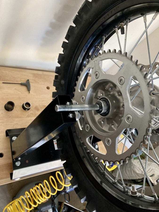

Rear tire pulled next. I got it up on the wheel balancer early as it lets me spin and inspect the rim and tire and also lets me spin and wipe down the rotor front and back with a cloth sprayed with brake cleaner. It also lets me get some of the china chain grease that started to finally melt now that I am riding the bike off of the tips of the sprockets so there is less mess later on when pulling the tire.

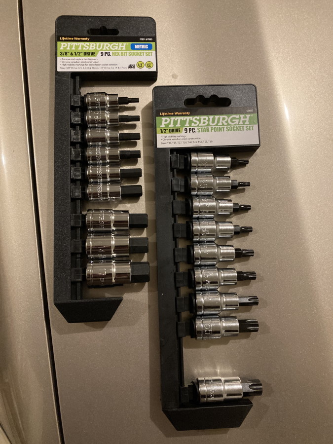

Looking at the sprocket for removal this is about the point in time where I realize two things.
  1. I don't have any star point sockets.
  2. I don't have any star point tools larger than T40 and the size used on the sprocket is a T45.
So off to the store I go. And now I am back, but the sun is setting, the air is getting even more annoyingly colder and I think I have had enough for a day well spent minus the faffing about getting missing tools.
Name:  Rear Tire Pulled and Realized Don't Have Star Sockets back from buying socket sets.jpg
I will have to as say leave the rest of the rear wheel work for another time. Until then...

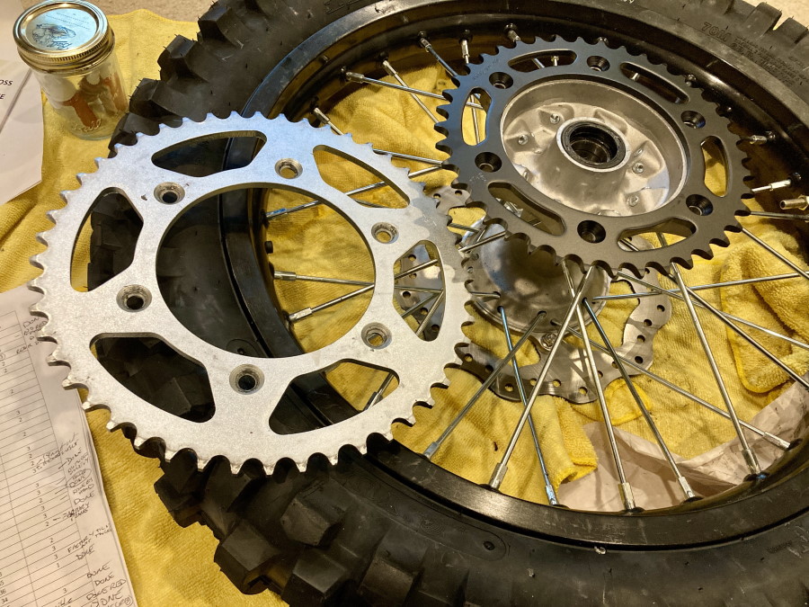

Old China Sprocket Removed
Name:  Rear Wheel Sprocket Removal.jpg
Side by side with the new sprocket for size comparison.
Name:  Rear Wheel Sprocket Removal Side by Side.jpg

Comparing the metal, teeth, and machining on the Chinese Sprocket and the Japanese (now made in Thailand) sprocket. I did not the larger amount of material left on the China one, possibly due to increase wear speed. (EDIT: There is less than 20 miles on the China sprocket in this photograph.)
Name:  New Sprocket and Old Sprocket Compared.jpg

Old 12-04-2022, 05:15 PM   #892
I'm curious what the balance of the wheels were before removing the rim locks.. on my bike with rim locks in i can feel a vibration between 40-60 mph which gets better overall the higher the tire pressure. I'm running 30psi in both and do a mix of gravel, dirt and street
Old 12-04-2022, 05:17 PM   #893

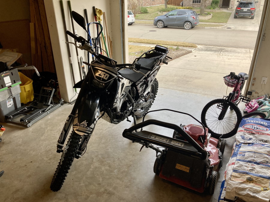

And thats it. I'm done. Too tired and sore to take it for a test ride. Maybe tomorrow .
Name:  End Of Project Finish.jpg
Old 12-04-2022, 05:19 PM   #894
They are definitely out of balance. I was going to take photographs but decided against it as it wouldn't matter in the end. I've pulled my rim locks and if you use them then you get gigantic monster weights that can go around the spoke wires. Looks goofy and you probably cannot get them dialed in perfectly but you can take some wobble out at speed on the rim lock wheels.
