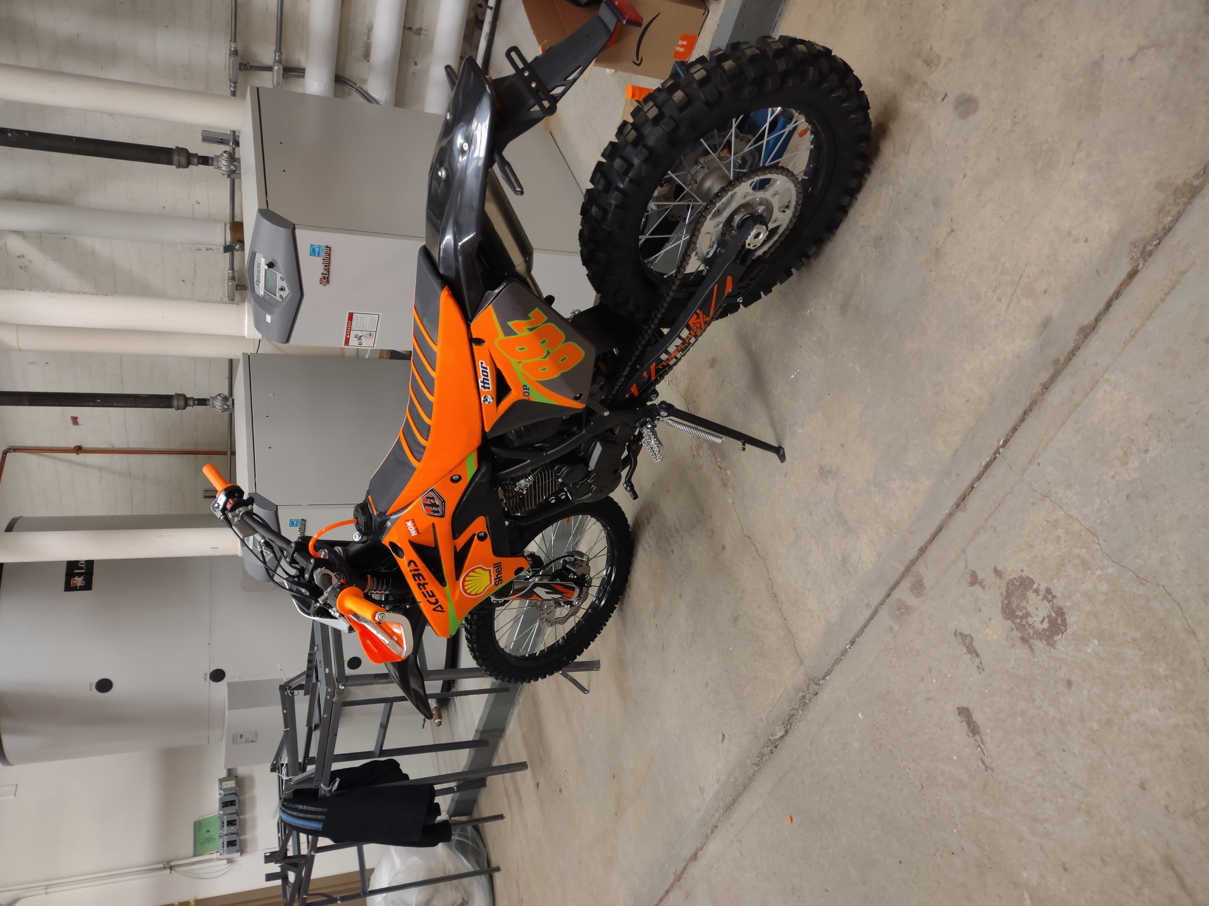

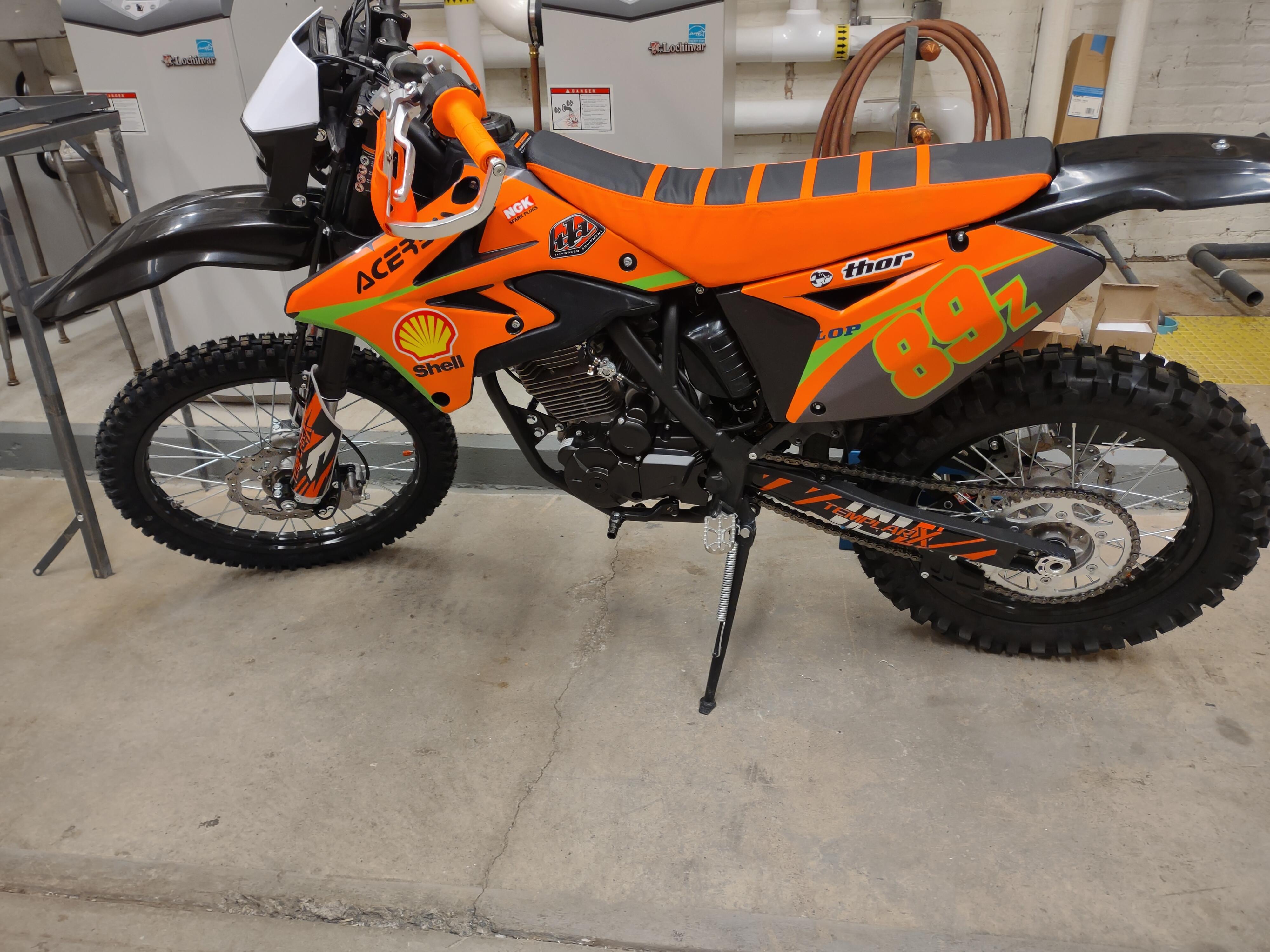

Finally coming together
Well, I finally got some work done on the X
Carb, jetted, idle screw installed and cables routed properly.
Seat cover changed.
About half of the new graphics applied.
Battery tray straightened and battery installed.
Working on the bark busters.
Still to do - get the skid plate fitted properly
Finish the bark busters
Finish the rest of the graphics
Put some fuel in and start it up.
