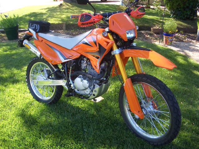

Old 03-05-2024, 12:57 PM   #4
I did the exact same setup with tires on Q when I was commuting! They worked well and lasted a long time. Very stiff tire. I added a removable tail bag for my lunches. Saved a ton on gas and made the commute fun.
