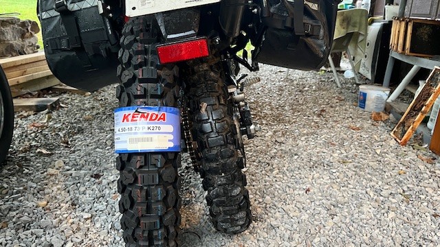

@CC-John. Hope you like yours. Mine came in today. I'm wanting to put it on now but I guess I need to finish out the ole Dunlop first.
I've been happy so far, only have about 20 miles on the bike so far. Just been riding the streets around the house since I won't get my plate for a couple of weeks. The K270's are really quiet and smooth on pavement, and seem to have good grip under hard acceleration and braking. I still need to play around with tire pressures to see how they behave, currently running 20PSI front and rear. Been mostly playing around with the rear shock getting the spring preload setup for my 235# carcass.
I also drilled another hole in the rear shock fork 3/4" up from the original to lower the bike some. Also bumped the forks up a couple rings in the triple trees. That got this steed a bit easier to throw a leg over. The first few times trying to mount or dismount at the stock height looked a bit like the flight of the stumblebum as I'm not as limber at 57 as I was 30 years ago when I last had a dirt bike.
