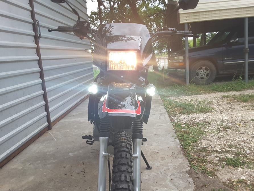

Speaking for myself (non rx3 owner, yet) the dim weak yellow incandescent bulb looks like a joke next to the bright aux lights (I also have auxiliary led pair but cheap ones for a cheap bike). Will be replacing h.l.bulb upon delivery.

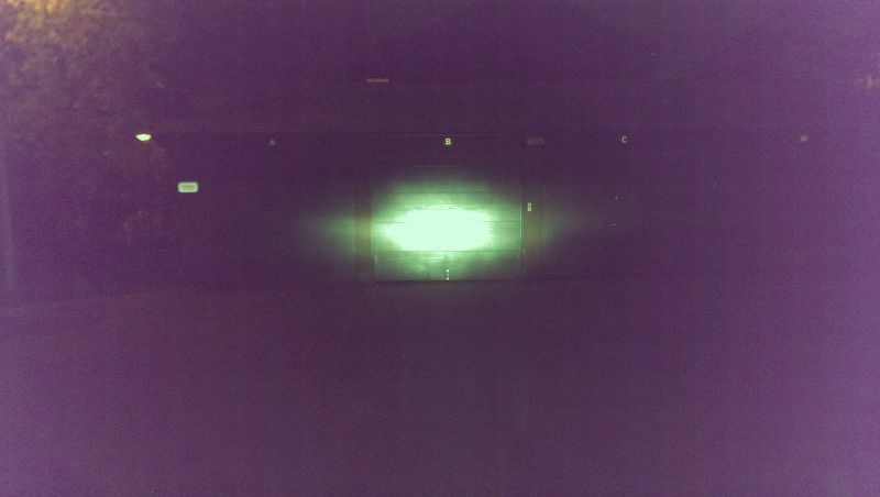

I put the GENNSI LED in the 2015 reflector and the results aren't very good on low beam. Sorry for the poor pics, but hopefully you can see enough of the beam pattern.
There are two big problems with the GENNSI LED in the 2015 housing:
  1. The low beam is blocked by the large hump around the lower running light, leaving a giant shadow in the bottom center.
  2. The light distribution is much narrower than the 2015.5 reflector, due to the space taken up by the side LEDs in the housing.
The high beam pattern in the 2015 is a little narrower than the 2015.5 reflector, but looks fine. The LED makes a huge improvement over stock.
Apart from these issues, the light output is still very good. But if you have a 2015 reflector, you'll have to decide if the low beam pattern is any better than what you have now.

GENSSI road test
I took Red 5 out for a night run and gave the new LED a good road test in my 2015.5 reflector. I ran it on city roads with streetlights and unlit rural roads with a few blind curves.
The light is more obviously blue reflecting off road signs than it was in my parking lot. In terms of color temp, I prefer a 5000K white light over this 6000K, but I'm not complaining. I'm just glad it's not any bluer.
The low beam provides excellent light to both sides of the road, actually better than the high beam. The cutoff works well but offers enough light bleed to light up the signs and road markers in the distance.
The high beam provides even better distance lighting and good side lighting, but not as good as the low beam. I'm still pleased with it and I think a pair spotlight LEDs will do a great job lighting the roadside, when the high beam is on.
IMO, if you have a 2015.5 reflector, there's no question that the GENSSI will be an excellent LED for you. If you have a 2015 reflector, it will probably be an upgrade for you. But the 2015.5 reflector is so much better, you should consider purchasing one from CSC for $120. I'm so glad I did. I would not go back.
