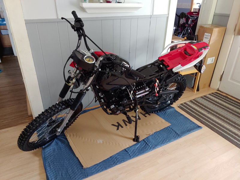

Took me a minute to get the pictures on here - that file size limit is a pita.
Anyway here's a few pictures so far. It's currently in partial built/tear down on a stand in my dining room. HEHE, waiting on lots of parts that I'm hoping start showing up. Need my head gasket first, that's my deepest mod and then I'll work my way out from there.
2020 RPS Hawk 250 - Build thread can be found here: http://www.chinariders.net/showthread.php?t=28374

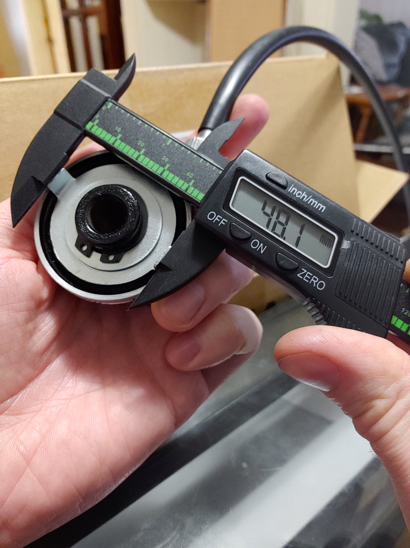

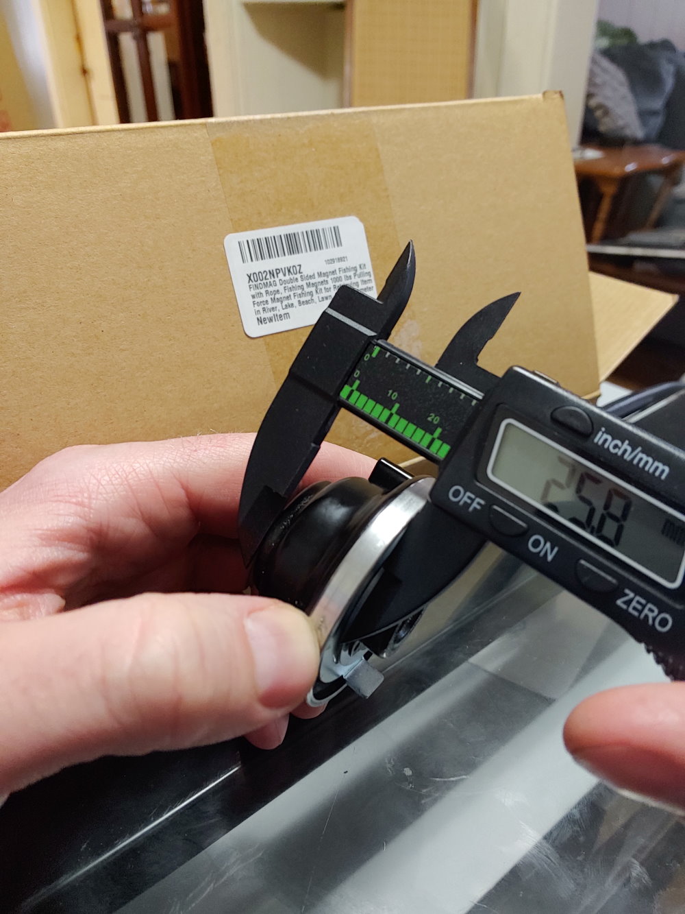

SOOOOO, some of you might have seen my other thread on Digital clusters. I've found one I like on aliexpress and I think I'll order it.
https://www.aliexpress.com/item/1005...33c72e0eeqop0c
My issue is figuring out a wheel speed sensor that will work....there's a few different sizes/styles.
So I took some measurements of the stock unit. So far, I'm thinking that this speed sensor MAY work (of course it has to be the most expensive one I came across)
https://www.aliexpress.com/item/4000...816c2e0eecpP6z

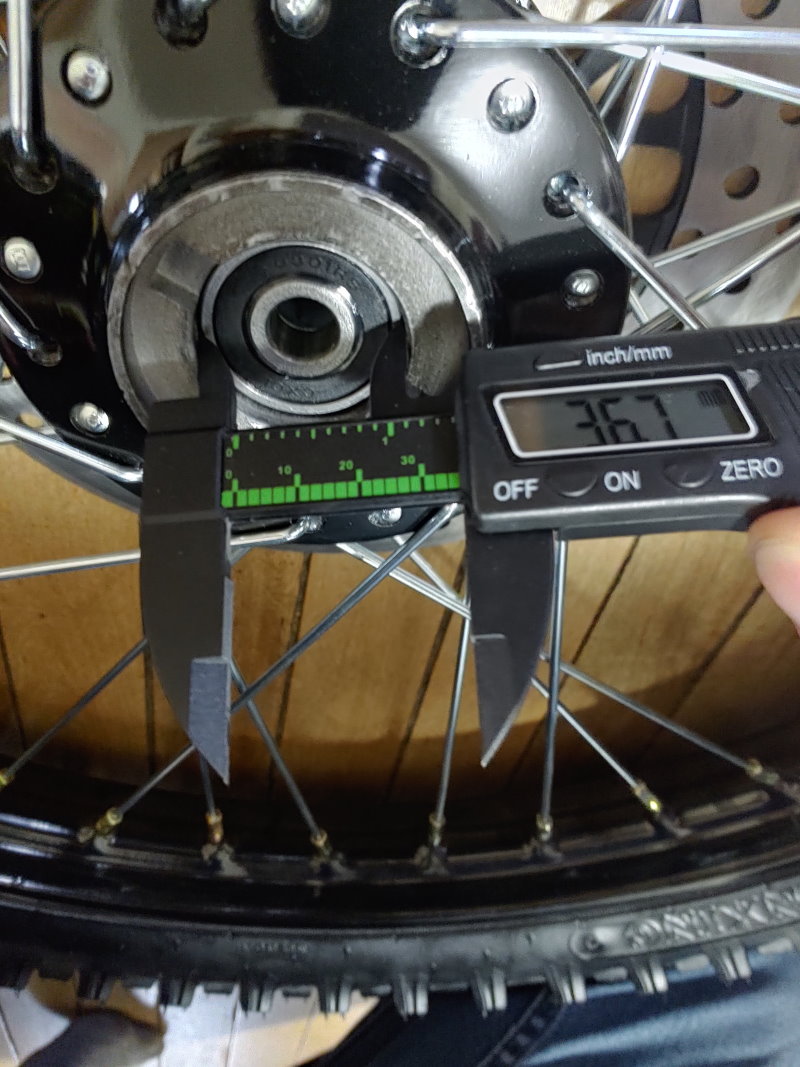

And here's a few measurements of the hub where the sensor sits. I'm thinking that the thickness of the sensor is quite important so that it all fits together nice and snug, no wobble, etc.
The "axle hole" could be slightly larger and I don't think that's going to matter, as long as the tabs that spin for the actual sensor fit into the notches in the hub. Is this making sense?
