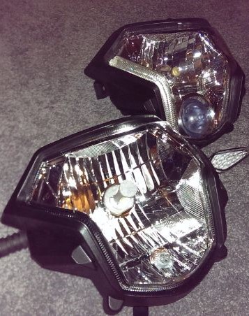

I'm actually changing two variables here: the LED and the headlight ... because I also ordered the new 2016 light assembly from CSC.
The new design removes the side LEDs and the large housing around the running light to improve the overall light pattern.
